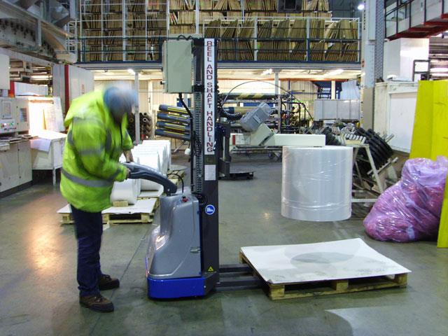

The carriage-mounted reel turner.
The system was trialed successfully at the customer's factory. RSHC then designed two different versions of the Reel Turner Mk3, four of which were to be mounted on Armanni "Speedylight" pedestrian stacker trucks' fork carriages and a fifth to be mounted onto fork pockets. The latter could be used on any warehouse forklift.

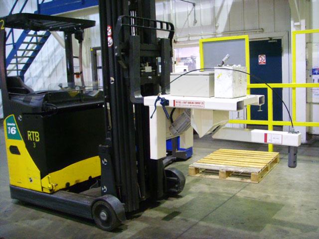

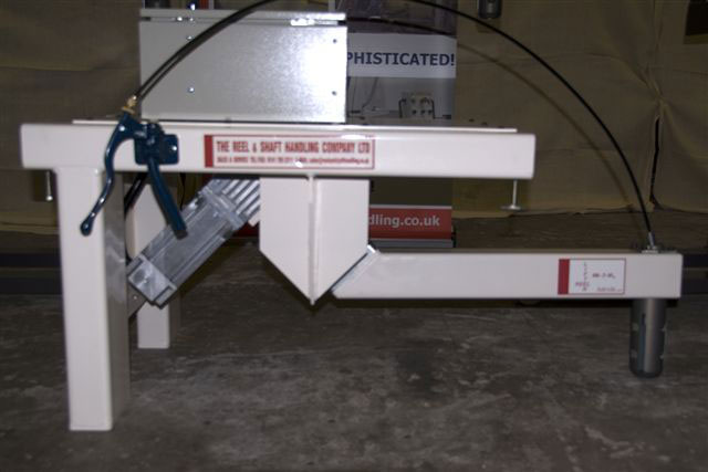

The Reel Turner Mk3 mounted on a forklift.
However, powering rotation on the fork pocket-mounted reel turner was more difficult. The customer's forklifts had different voltage systems and only several were fitted with extra hydraulics.
The company recognised that future sales could have the same problem, so its designers developed five stand-alone models, each with a different means of powering the rotation: electric-powered from the stacker, electric-powered from its on-board battery, hydraulic-powered from the stacker, hydraulically powered from an on-board hydraulic pump and manually rotated with a hand wheel and gearbox.
