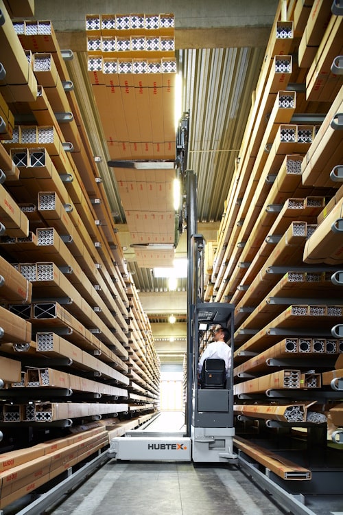

The new PhoeniX 2829-XS and 2921-S from HUBTEX were specifically designed for use in narrow-aisle warehouses.
Companies short on storage space often opt for a narrow-aisle warehouse, preferring to pack their products high to minimise aisle width. This means reducing the safety clearances between each side of the industrial truck and the rack from their usual 500 mm to a minimum of 100 mm. It also places greater demands on the materials handling equipment, requiring it to be strong, compact and manoeuvrable in order to transport and lift long loads along the narrow aisles. HUBTEX's new PhoeniX 2829-XS and 2821-S series have been developed specifically for use in narrow aisles.
“Lift truck drivers can manoeuvre safely while also lifting their customers’ specific loads without causing any damage because the vehicles are so compact and come equipped with integrated rack guidance systems such as mechanical, inductive or optical track guidance,” says Michael Röbig, Head of Product Management. “Space-saving sit-down or stand-up cabs also give lift truck drivers an unbeatable all-round view. At the same time, assistance systems such as the mobile personnel protection system fitted to the vehicle, which uses laser scanners, helps to improve employee safety even further.”
