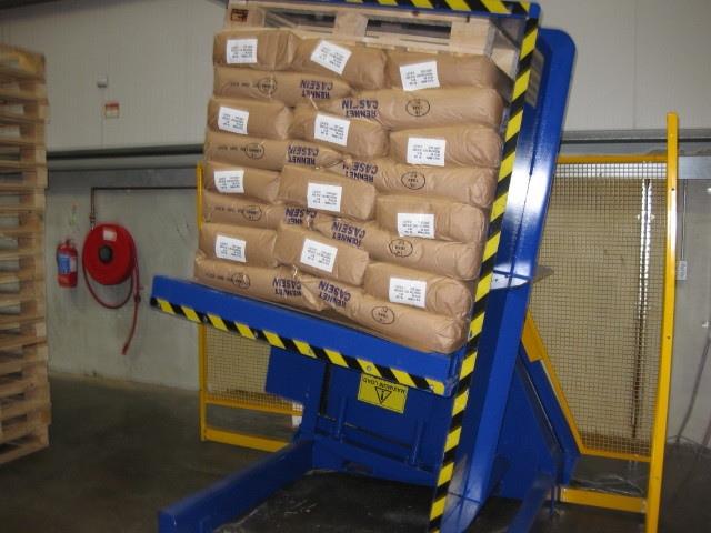

A customer at this facility, Store-All Warehouses, recently invested in a Premier pallet inverter and two sets of RollerForks®. Store-All Warehousing needed to ship high volumes of FIBCs containing milk powder to a customer outside Ireland. Each FIBC weighed around 1,000 kg and had to be shipped in 40-ft sea containers.

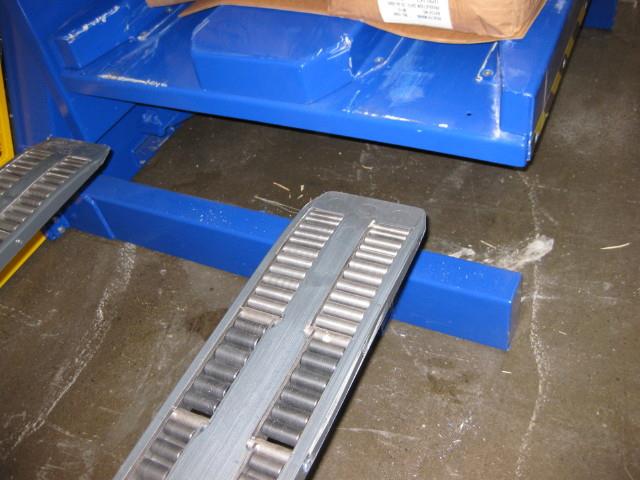

Normally, FIBCs are stored internally on pallets, but pallets are very expensive and even more costly when they have to be pre-heated in line with ISPM 15 regulations. Store-All Warehousing now loads FIBCs using far cheaper slipsheets. Forklift truck drivers collect palletized big bags from the warehouse and place them into the Premier inverter near to the loading bay. The inverter is fitted with special-purpose pockets for use with RollerForks® to improve handling speed. When the load is turned, the pallet can be taken away and replaced with a slipsheet. RollerForks are then inserted into the pockets to extract the slipsheeted FIBCs from the inverter. The forklift truck then drives into the container, places the slipsheeted load onto the floor and reverses out leaving the load in place.
RollerForks® are in fact regular forklift truck tines made up of two layers of rollers. When the bottom row of rollers touches the floor, it causes the top row of rollers to rotate in the opposite direction thereby allowing the forks to slide under the slipsheet without damaging the load. When the forks are raised, the rollers drop lowering the load safely onto the upper side of the forks, and vice versa enabling the products to be unloaded in the opposite loading order. RollerForks® have unique characteristics compared to familiar push-pull systems. These characteristics include:
