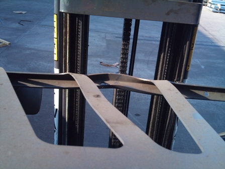

The experienced forklift engineer identified visible damage to the forklift's overhead guard.
An industry expert has voiced concern over the validity of some Thorough Examinations after the discovery of a forklift that was given the nod by an inspector despite the presence of serious structural damage.
Chas Day, technical manager of Consolidated Fork Truck Services (CFTS) which administers the Thorough Examination scheme, says weeks after the forklift was given a clean bill of health, the truck's poor state of repair was discovered during a routine service by an experienced forklift engineer.
The engineer who is qualified as a "competent person" for the Thorough Examination of forklifts, identified visible damage to the forklift's overhead guard, which could have compromised protection against falling objects like laden pallets displaced at height.
Further investigation revealed unnoticed cracks to the chassis and the carriage. The service engineer also identified the cause of the damage to the overhead guard. It was being used as an anchor point for towing a 7.5 T lorry.
"For the stress to have caused this damage to the guard, it is quite likely that other structural damage will have been done to the forklift, some of which may put the operator at even greater risks," Day explains.
