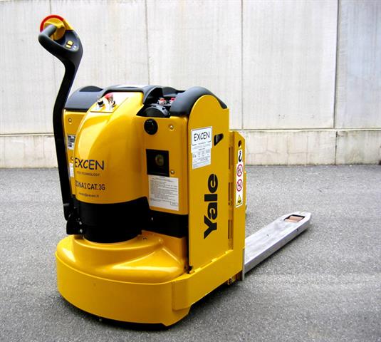

Excen converted Yale

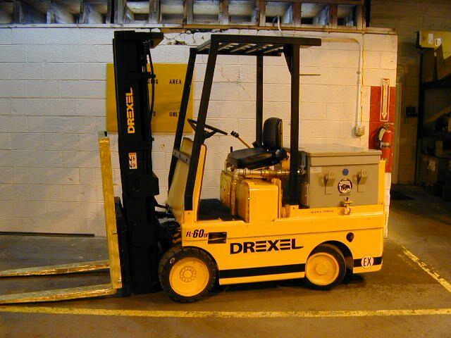

Landoll-Drexel Ex modified forklift
An explosion- or flame-proof forklift (EX) is one which has been modified or built from the ground up for use in zones 0, 1, 20 and 21. These include mining tunnels, oil and gas platforms and production plants; chemical, paint and perfume manufacturers; grain, sugar and cement silos and production facilities; and ammunition stores. As Malcolm Davis, business development manager for Pyroban, explains,"in explosion-proofing, the basic principle is to eliminate the forklift as a source of ignition in these zones".

Exclusion means that the explosive atmosphere is prevented from entering equipment and contacting the source of ignition. This is achieved by explosion-proof coverings which are either screwed or bolted on and made from steel or resin. Although gas sensors do not exclude gas from entering the machine, they quickly alert operators of a potentially explosive environment. Technology such as Pyroban's Gascheka tests ambient gas levels and automatically shuts down or de-energises the equipment if 25% LEL (lower explosive limit) is detected. The Gascheka can be retro-fitted to both diesel and electric forklifts.
Excen produces an integrated gas sensor system that eliminates the need to carry the calibration gas bottle on board, thereby making it a safer option in zone 1 areas.

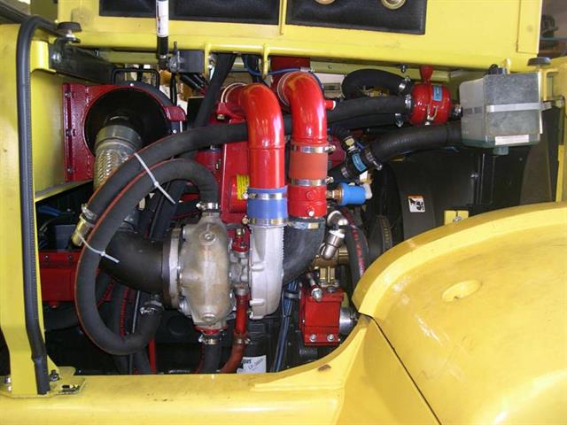

Hydronika Ex modification for turbo engine
Robin Chapman, principal engineer at Pyroban, has seen an increase in turbo-charged diesel forklifts being used in zones 1 and 2. This is of some concern, he says, as they are typically uncooled and generate extremely high operating temperatures. Chapman says that Pyroban has developed a unique water-cooled turbo-charger with explosion protection which overcomes these problems while still maintaining engine power.
