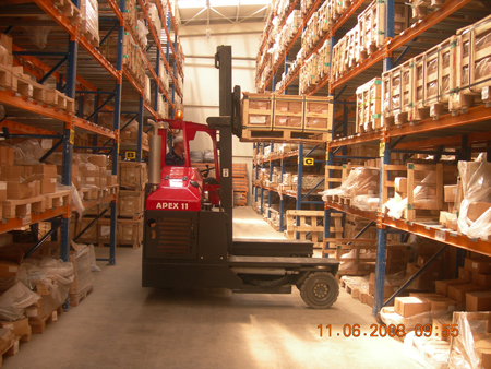

We are glad to present you our new product, which is developed and produced by APEX 11- the 3 wheels driven multidirectional Forklift truck with travel mast -A-Lift.
A-Lift - safe, rapid and effective material handling
A-Lift is 3 wheels driven multidirectional Forklift truck with travel mast.
It combines the features of three different Forklift trucks:
  • Forklifts for side handling of long loads in aisles,
  • Forklifts for front handling of pallets and more compact loads,
  • Four-way (Multidirectional) Forklifts.
The assembly components which are most important for reliability of the forklift are from well known companies: Kubota (Japan), Sam Hydraulik SpA (Italy), Poclain Hydraulics Industrie SAS (France), Aron SpA (Italy), Bosch Rexroth AG (Germany).
The engine is KUBOTA V2403-M . It meets the requirements of EPA Tier 4 and EU Stage 3A.
The transmission is on basis hydrostatic components. The 3 hydrostatic motors are Poclain, and the hydrostatic pump is Sam Hydraulic.
In lengthwise drive, steerable is the rear wheel. In crosswise drive, steerable are the front two wheels.
The four direction lever-switch enables a quick direction selection for lengthwise and crosswise driving.
Special attention is paid to the driver's place. The driver has good all round vision, a comfortable suspension seat is also fitted as standard and an integrated easy-to-read instrument panel maximizes driver's efficiency.
The inching valve (connected with the inching/brake pedal) allows the driver to move the forklift very slowly.

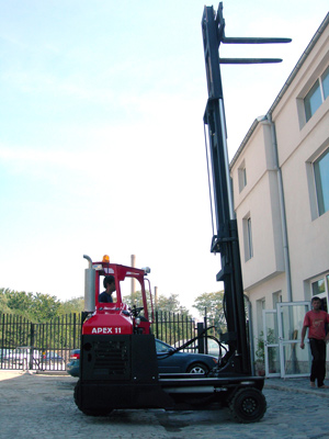

The Lifting mast has travel (reach distance) of 1280 mm.
