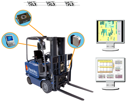

Craig McKenzie, marketing manager for Australian-based Peacock Bros. Pty. Ltd, says a technology the company originally designed to make warehouses more efficient now plays a large role in occupational health and safety.
The company has taken existing technology and tweaked it to provide a system that can be adapted to a workplace's specific requirements. Peacock's Indoor Vehicle Positioning System, which incorporates RFID forklift-mounted technology and real-time warehouse management, was originally designed for use by New Zealand company Eastpack. The company recently won an award for this technology (Forkliftaction.com News #397).
"We have combined RFID technology software with a positioning system and our specially manufactured backrest," he explains. "Normally, equipment on backrests requires a lot of cable, but we have designed and built our own Bluetooth transmitter and put a battery pack into the backrest, making it completely independent."
McKenzie says this technology reduces the need for operators to get on and off the machine because it reads is able to locate pallets, knows where to put them and how to find them using the warehouse management systems (WMS) "The driver never needs to get off the forklift thereby reducing the circumstances that creates the accident."

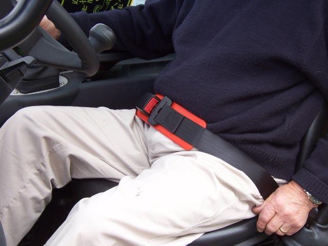

It is hard to imagine that a seatbelt - a simple concept that works - could be improved upon. The problem with seatbelts is operators often forget or cannot be bothered to put them on.
Don Wilkinson, manager of New Zealand-based Industrial Seatbelts, distributes Springbelt. He says he originally developed the belt to overcome the disregard most operators have for seatbelts in earthmoving plant. "It is ideally suited to forklifts."
The belt springs up when unbuckled, making it a real nuisance and uncomfortable to operate the machine. But when it is buckled, it holds the operator firmly, comfortably and safely in his seat.
The belt comes with a universal fitting kit making it easy to install.
"Springbelt overcomes most of the difficulties for the operator and the employer. It takes the conscious decision out, overcomes the macho bit and makes compliance more certain and predictable."

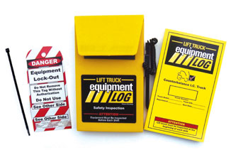

Forklift Training System provide electornic logs
Forklift trainers such as Forklift Training Systems believe many accidents can be prevented with adequate and ongoing training. It provides forklift training for both new and existing forklift operators and train-the-trainer classes for new forklift trainers.
David Hoover, president of Forklift Training Systems, says when doing on-site classes, the trainers insist on looking at the forklifts and workplace before training. "This is so we can make recommendations to improve material handling safety and to customise our program to the site and lifts as much as we can."
