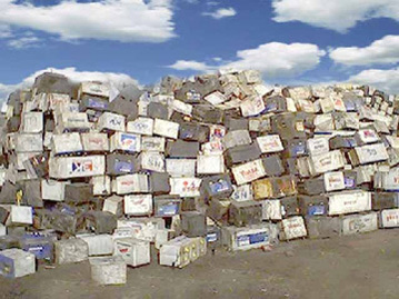

Another area that has undergone significant advances is battery rejuvenation. It is no longer necessary to throw out batteries that appear to have run out of juice. Too often, businesses throw out batteries (and money) believing they have lost power due to sulfation.
Sulfation is an electrochemical reaction that occurs when the battery is discharged. During normal use, a battery's sulphuric acid is active between the lead plates and this creates electric current. Sulfation occurs when the electrolytes in the battery crystallise onto the plates. The loss of sulphuric acid reduces the electrolytes and transforms into water. This leads to reduced cell voltage and a reduction in charge.
Batteries waiting to be rejuvenated
It is accepted in the industry that 70% to 80% of all "broken" lead acid batteries have nothing mechanically wrong with them, but have sulphated plates.

Batteries can be saved
For Philadelphia Scientific, the environmental concerns are a good thing. Parkinson believes it forces customers to consider how long their batteries are lasting. "We can provide technology that extends the life of the battery.
