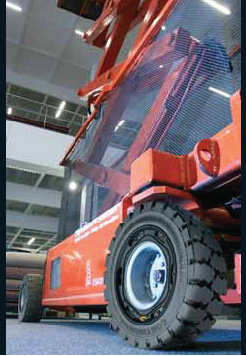

Continental has developed an innovative forklift tyre & wheel combination solution called CS Easy which has been launched progressively over the past 2 years.
Solid Super-Elastic tyres are robust, durable and require minimal servicing. They save energy and are exceptionally shock and wear resistant . That's why, for many applications, Super-Elastic tyres are the first choice - and in particular Continental's premium CSE range. Now Continental's engineers have developed a new range of tyres that will revolutionise Super-Elastic tyres forever.
Introducing Continental's CSEasy - quick, easy, flexible fitment.
CSEasy is the first Super-Elastic tyre that requires no press, specialist technician or equipment.
Tyres can be fitted in situ, as soon as the tyre breakdown occurs, ensuring the forklift is back in full operation in minutes.

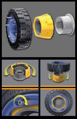

Press-less fit to rim
The key to CSEasy is the innovative adapter which is placed between the tyre and rim.
Thanks to the adapter's conical shape, the tyre is already in position and is simply screwed onto the rim using a torque wrench - making the press redundant.
CSEasy does it
Two hands and a torque wrench are all you need to fit the new CSEasy tyre on any Lemmerz type rim.
