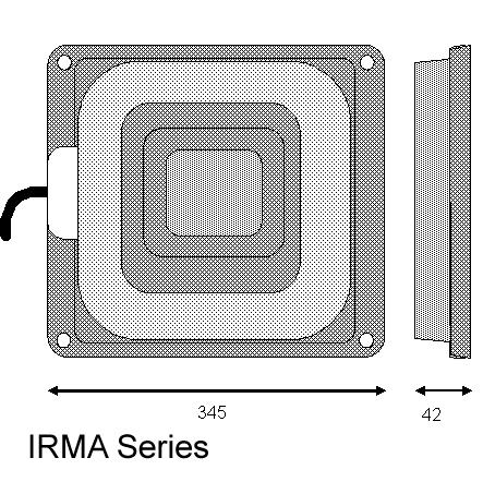

The IRMA series incorporates an antenna, reader and communication interface in the one module and uses RealRFId's mount-on-metal technology to maximize sensitivity in the narrow space under a forklift truck. Up to 0.7m read distance can be achieved at speeds of 15km/h due to the rapid read cycle. The metal chassis does not affect tuning or significantly lessen read distance. Installation is therefore greatly simplified and costs kept down.
IRMA Specifications
  • Size: 345 x 345 x 42 (plus lead). Operating voltage 12V - 24V at 12W.
  • Output comprises opto-isolated RS232 and opto-isolated output switch.
  • Compatible with TIRIS low frequency HDX transponders.
  • Customised response to certain transponder numbers
  • Strong moulded plastic construction.
