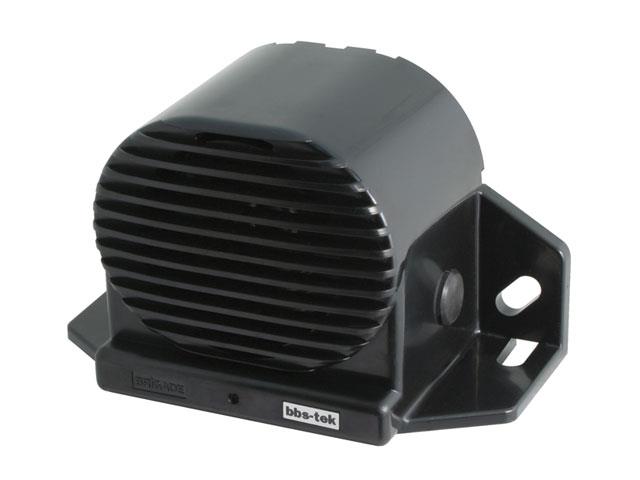

Brigade Electronics Plc of Kent, UK claims it is the only company in the world to provide a complete range of reversing safety systems. One of its products is the bbs-tek reversing alarm that has been written into the Olympic Delivery Authority's Code of Construction Practice for the 2012 Olympic Games and all construction sites in the greater London area.
Brigade general manager Henry Morgan boasts there are over 8,000 bbs-tek alarms fitted in US cities, ports and construction sites. He says the alarm is the only reverse alarm to be approved by New York City's Department of Environment Protection for use near "sensitive areas" like schools, hospitals and places of worship.
Brigade Electronics' broadband based sound alarm
With sound levels ranging from 77dB(A) to 97dB(A), the alarm has a small microphone that measures the ambient sound pressure level and then adjusts the alarm to maintain a 5dB-10dB higher volume so it can be heard. Besides forklifts, it is used for trucks, buses and light mobile plant machinery.
Lemke says reverse alarms are only useful if the pedestrian can be alerted to the hazard.
"Unfortunately, because of the monotone, regularly intervaled alarm noise becomes part of the background noise and people except the forklift operator don't actively hear it."
Morgan says the bbs-tek alarm uses broadband sound commonly known as "white sound" that is more effective than conventional alarms. The alarm is the only broadband sound alarm available as Brigade holds the patent to using broadband sound for reversing alarms.
"The sound is directional, unlike tonal alarms, enabling people to detect which vehicle is reversing and taking appropriate action to move to safety."

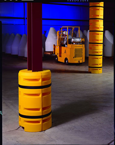

Lemke says racking supports seem to continually get struck by forklifts and loads.
"This damages the structural stability and causes racks to fail and loads to fall. Careful driving and replacement of damaged rack supports (are) critical."
This need has created a niche for manufacturers like Column Sentry Protection Products of Lakewood, Ohio, US. The firm has sold over 70,000 of its Column Sentry products worldwide to clients including General Motors, Dana Corp and Chrysler Corp.
The Column Sentry, a protective shell for steel columns, consists of two low-density polyethylene symmetrical halves that are strapped around structural columns, forming a protective cylinder. They are semi-flexible and stress crack-resistant. Each half is an airtight shell designed with air-chambers to absorb nearly 90% of the energy produced when a forklift accidentally collides with a warehouse's steel columns.
Weighing about 34kg (75lbs) and 64cm (25 inches) in diameter, the protective shell lessens damage on columns and racks, and prevents the bending of building structures and rack collapse when a forklift crashes. By absorbing energy from the impact, it also prevents whiplash for the operator.

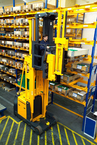

The use of advanced technology for forklift safety in warehouses is evident in Jungheinrich turret trucks. RFID technology has been incorporated into the control of the EKX513 and EKX515 turret trucks to help them avoid hitting warehouse obstructions.
RFID transponders are located in the warehouse floor and RFID transponder readers are mounted on the turret truck. When the truck is installed in the warehouse, the transponders are programmed with information that identifies the precise location of the transponder and corresponding truck operational restriction information.
For example, in an area of an aisle that has a low-hanging obstruction, transponders and truck controls can automatically limit the lift height of the truck in that specific area to prevent an inattentive operator from driving into the obstruction.
PSS
Personnel safety system (PSS) is also available on the EKX 515 series turret truck. The PSS uses a laser scanner to monitor any obstructions that may exist either in front of (or behind when travelling in reverse) the turret truck operating in a very narrow aisle.
Jungheinrich EKX turret truck
VNA operation is unique because there is very little room between the truck and racking. So if someone is in the aisle at the same time as the forklift, there is no place for that person to go to get out of the forklift's way.
The PSS scanner is intended to protect against the forklift hitting the pedestrian by first slowing the truck down automatically and then stopping the truck automatically if the truck gets too close to the pedestrian or any object that is in the forklift's path.
The scanner can be set to scan any prescribed distance in front of the truck.
"Ideally, this is set far enough out so the speed of the truck can be reduced to a stop prior to the truck coming into contact with the obstruction in the aisle," says Jungheinrich's Mason. "In theory, it could prevent a head-on collision between two trucks provided the scanning distance was set far enough so the system would have the time to cause both trucks to be seen and then slow down and stop prior to a collision." Under normal circumstances, however, users do not have more than one VNA truck operating in a VNA at any given time.
The system works by the PSS sending a signal to the truck controller identifying that there is an obstruction in the truck's travel path. The controller then automatically starts to reduce the truck's speed. If the obstruction remains in the truck's path and starts to get closer, the PSS sends a signal to the controller indicating that the truck should be stopped.
The scanner can scan for loads and pallets at the first level of racking and even small boxes sticking out into the aisle. It is mounted on the truck chassis, low to the ground and is intended to scan the aisle, reducing the potential for product or forklift damage.
