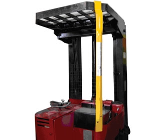

Canada's Department of National Defence, which supports the Canadian Armed Forces, has adopted The Backbone® for Reach Trucks to protect its standup forklift operators from underride accidents.
The DND has internally designated The Backbone as the "Bow Handle", undoubtedly because of its resemblance to an archery bow. But, regardless of the name, it still performs the same critical safety function when installed on your reach trucks and standup forklifts.

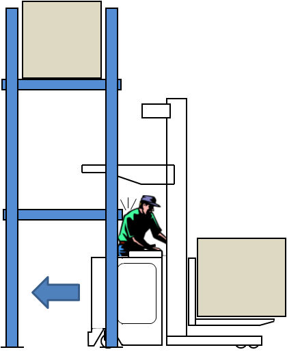

Standup forklift underride can occur when a horizontal rack beam can penetrate the operator compartment. If there are no pallets or stock on the floor, and no bumpers at the height of the overhead guard, the forklift is free to keep backing up, crushing the operator between the rack beam and the front of the compartment. You can see an illustration of an underride accident in the video below.

But often, these actions are impractical. The authors of the ASME report concluded that additional forklift guarding, such as rear vertical posts extending from the forklift body to the overhead guard, will prevent injuries associated with horizontal intrusion collisions.
Lakeport Metalcraft Inc. has been manufacturing The Backbone® Safety Bar for Reach Trucks & Standup Counterbalance Trucks since 2011. The Backbone® is fully compliant with the ANSI B56.1 Standards, offering protection against collisions up to 1.6 km/h.
Standup Forklift Underride

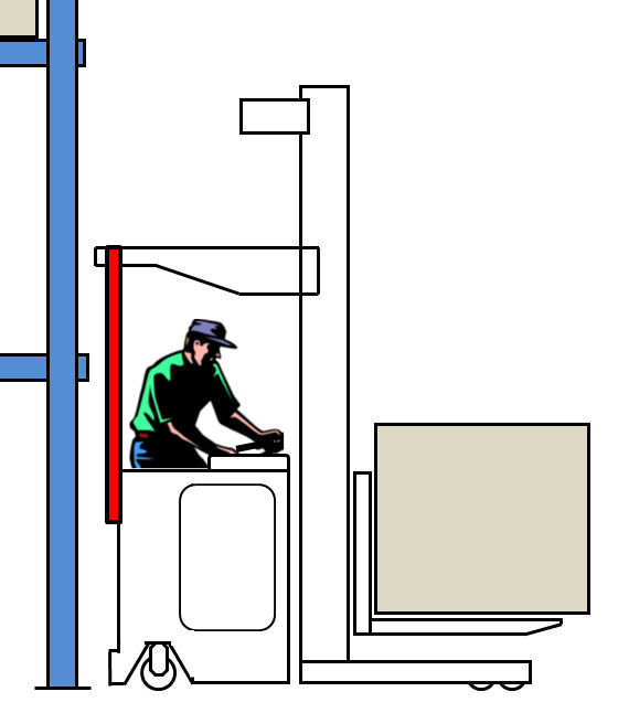

Standup Forklift with Rear Guarding
