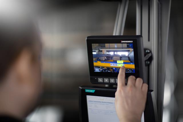

Jungheinrich has launched its digital fork camera for scanning goods in a warehouse, the latest addition to the addedVIEW optical assistance system.
Felix Riesenhuber, head of product management assistance systems and modules at Jungheinrich, explains that with the help of the digital fork camera for reach trucks, barcodes on the storage compartments and goods can be read. By networking the assistance system with the customer's own goods management system via the Jungheinrich Logistics Interface, an actual comparison of the barcode contents with the specifications of the goods management system is possible.
"When barcode lists are scanned manually at the shelf compartments or on order papers, which has been common practice up to now, errors occur time and again because the place of storage is not directly checked," says Riesenhuber. "The digital scan using the new fork-arm camera now effectively helps to prevent storage and retrieval errors and the associated search times and missed trips."
Even under difficult lighting conditions, the digital fork camera can guarantee high image quality by dynamically adjusting the exposure parameters. By digitally sharpening the contrasts, the high-resolution camera makes it possible to reliably detect the QR codes, even on the upper shelf levels.
