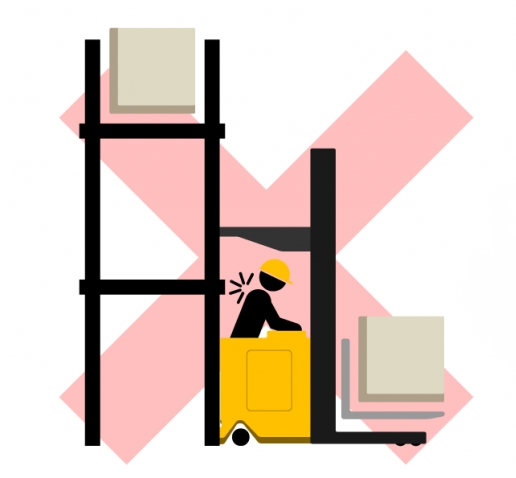

Standup forklift underride can occur when a horizontal rack beam can penetrate the operator compartment. If there are no pallets or stock on the floor, and no bumpers at the height of the overhead guard, the forklift is free to keep backing up, crushing the operator between the rack beam and the front of the compartment. You can see an illustration of an underride accident in the video below.
In a 2008 report, the American Society of Mechanical Engineers (ASME) stated that "greater than 50% of . . . 3,000 accidents studied involved a collision between a stand-up forklift and a stationary object, resulting in . . . 700 serious injuries and 22 deaths . . . of operators."

Reach Truck Hazard
Reach Truck Hazard

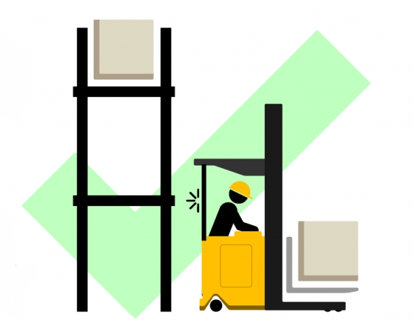

Backbone® Solution
Backbone® Solution
