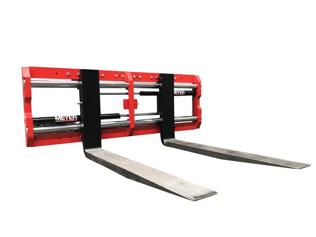

Clean, compact and robust - the new ISO 4 high capacity heavy duty Fork Positioner
MEYER now extends the Series Generation G in the capacity class ISO 4 with capacities up to 14 ton at 600 mm load center.
In the middle of the eighties Hans H. Meyer GmbH had already began the development of the Shaft Guide Concept for forklift truck attachments, which lead to the introduction of the first shaft-guided Fork Positioner. From the beginning to date, solid material precision-machined and hard-chromed shafts, in combination with long-life bushings (encapsuled with shaft wiper seals) provided for excellent smooth movement characteristics with fast operation speed, and equal fork travel. The long-life bushings with their extended life require a minimum of maintenance, which, with its optimised TCO, predestines this fork positioner for full-maintenance and fleet operations.
Maximum versatility
With the attachment frame width being independent from the carriage width of the truck a maximum opening range is provided for a handling of various load sizes. The fork carriers, with their flexible fork adjustment, can utilize different fork sections for use of standard truck forks. Wider fork hooks, or special fork widths, traverse freely over the outer attachment frame - the full opening range remains available. The heavy-duty fork positioner is also designed to work with extreme long forks. The fork carriers are pre-drill as standard for easy retrofitting of bolt-on forks.

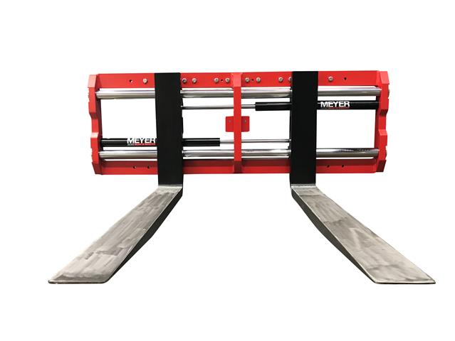

MEYER Heavy Duty Fork Positioner fitted with special tapered and coated forks for the wood industry
Extended product program - heavy duty design for maximum performance in arduous applications
The new generation 6-25xxG is now being extended into the capacity class ISO 4 with capacities ranging from 6 up to 14 ton at 600 mm load center and various chassis widths for all truck sizes.
The new welded frame construction with optimised weight and lost load is designed for even the hardest applications; excellent visibility through the attachment ensures safe and easy handling operations. The valve in a central, protected frame position ensures precise fork synchronism and allows for an easy installation to the truck hydraulics. The compact frame design with no elements protruding over the upper frame bar is also suited for container handling.
Any kind of standard and special forks with fork lengths even well above 2,400 mm, hooked on or fitted with extra bolts, can be fitted to the robust and versatile pre-drilled fork carriers.
