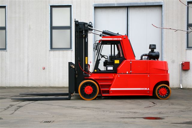

MORA model M 250 CS
MORA model M 250 CS
Cees Halling, region sales manager for Dutch dealership BS Forklifts, says it is a similar story in Europe. "We are seeing more 'problem cases' and our sales team is becoming specialised in calculating capacity and load centres, working areas and, most importantly, dealing with unexpected circumstances - low passages, dangerous production methods, etc. It is very important to visit the working area to be able to suggest the correct forklift." For example, at a logistics centre in a large Dutch steelworks, where space was limited due to large end-products and small warehouse space, a Mora 25T M250CS with a length of just 4.45 m and a width of 2.2 m was suggested.

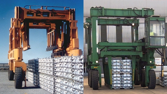

Isoloader straddle carrier lifting ingots
Heavy loads are usually large and often bulky, so physical size poses a number of challenges including load and truck stability. Mann agrees that stability is a key concern with many heavy lifts and that one of the advantages of using straddle carriers is that the weight can be evenly distributed, sometimes over more than one machine. "Using tandem machines provides even lighter load distribution over more wheels and provides very good manoeuvrability often critical in tight access or confined work sites," he explains. A good example of this system in use was Isoloader's contract to handle 35 m,
70 T concrete girders on an open project site with unsealed surfaces. Two straddles operated in tandem at each end of the load, ensuring traction and manoeuvrability in all conditions.
Tom Schults, managing director for Australian manufacturer Mobicon Systems, adds, "When a forklift lifts a heavy load, almost all the weight is on the front axle. This means that a forklift carrying a 35 T container will have an axle load of around 75 T.
Many surfaces cannot handle this load and damage to the yard surface occurs, exacerbating the problem between an uneven surface and forklift stability."
According to Mobicon, its products have the lowest wheel weight in the world and, being a straddle carrier, can work on imperfect ground - including light concrete - without destroying it.

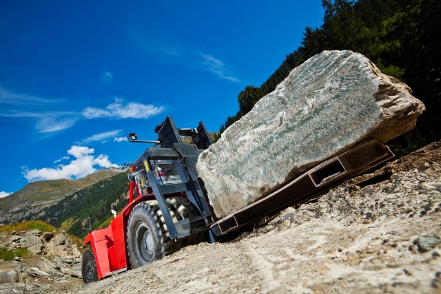

Tipping is an ever-constant concern when lifting extremely heavy loads. To ensure full stability in SANY's forklifts, it has implemented anti-tipping sensors throughout the forklift to avoid overloading. In the case of reach stackers, there are two anti-tipping devices. The first works through the hydraulics, sensing pressure fluctuations. The second is a sensor which continuously measures pressure in the rear axle. Whenever the pressure goes beyond a point, the operator is alerted to a potential tipping event.
Kalmar DCF500-12 lifting at a Swiss quarry
Hellström agrees that one of the main technical challenges is to have tyres and drive axles that can support the extreme loads that heavy lifting creates, but he believes that the mast and forks on a forklift also come under enormous stress. In 2012, Kalmar delivered a DCF500-12 to a stone quarry in the Swiss Alps. The forklift had a lift capacity of 50 T at a load centre of 1,200 mm. It was used to handle huge stone blocks over uneven terrain with steep slopes in muddy conditions. Kalmar addressed the issues that the site and application posed by using high-strength steel for mast and forks and appropriate lift attachments.

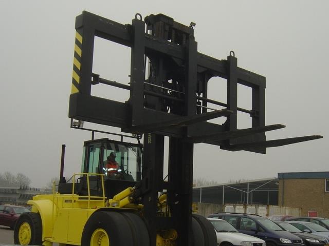

Matching attachment to lift requirement is vital and sometimes challenging in heavy lift applications. Bell of MSI explains " It is often the case that the pocket size a fork attachment is required to fit into does not get larger as capacity increases, this means that fork attachments for heavy lifts need special steel alloys and advanced forging and heat treatment to meet the forklift's lifting requirements. Forklift arms are often virtually hand-made to suit a heavy lift application.

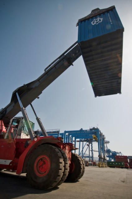

You cannot talk about heavy load lifting without some mention of the unique challenges in that most taxing of forklift environments - the port terminal. Reach stackers and container handlers make up some of the heaviest load lifters in the sector and both are found at ports and their storage facilities. Ports are challenging both in their physical working environment and in their logistics.
Salty, muddy roadways at ports, often with pot-holes from excessive use at ports require a robust machine. "It is not only the constant flow of materials handling and the need for durability but the extra protection and engineering required for weather, sand, mud and salt on attachments and forklifts which is the challenge," Barbier explains. "These environments are brutal if the forklift operator doesn't understand general safety instructions for loading."
Mann agrees that port sites are often corrosive environments and says that attention to detail on cabs, such as IP ratings of penetration, gaskets and enclosures, not only provides operators with superior comfort, but also prevents premature degradation of control systems.
Cascade's spokesman says that one of the unique challenges when designing products for use in ports is to engineer an attachment that can both handle the large capacity and be durable.
With shipping containers, he explains, the challenge is height, travel distances, movement volumes and environmental concerns. With bulk freight, it is having the correct equipment on call to handle the vast array of loads that come through the port, such as designing a high capacity pulp bale clamp that can move 64 bales of pulp at a weight of 18,000 kg at once.
Klaus agrees that there are some special requirements at ports and terminals. The growth in trade and containerisation, he believes, has exceeded investment and expansion at ports, forcing them to higher density storage and higher stacking. In addition, the high level of traffic plus the big ships often contribute to high levels of pollution, so low-emission engines are important.
The waterfront is a 24/7 economy, which asks a lot of endurance from the people and equipment that work there. Minimising downtime through reliability and ready access to parts is vital. Marcel Vanden Top, general manger for parts supplier Intella Lift Parts, says that ports customers are most interested in top quality spare parts with 24 hour availability. "They simply can't afford for one of their pieces of equipment to be down," he says. If the equipment is out of action, the containers don't get moved, another ship comes in, and the whole system gets backed up. He adds that many terminals are global organisations that demand global supply arrangements - they don't want to pay one price on one continent for a spare part, and then another price on another continent.
And did we mention size? Kalmar recently entered the record books thanks to the heavy lift capabilities of its latest reachstacker, named Super Gloria. The reachstacker lifted a steel component weighing over 100 T in September 2014 at Kalmar's multi-assembly unit in Lidhult, Sweden.
