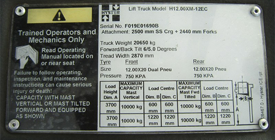

The load capacity data plate specifies the load each forklift can safely lift.
What is a load capacity data plate?
The load capacity data plate specifies the load each forklift can safely lift at different mast angles or when it is fitted with an attachment. The plate should display: the load capacity, lift height, load centre distance, brand and model number. The plate should also display:
* Down rating of lifting capacity if a mast is fitted
* Down rating for specific attachments that are identified on the capacity plate
