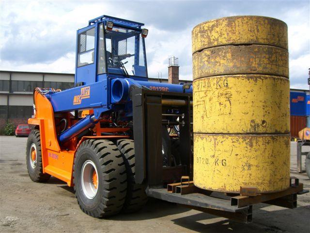

ML 3012RC - With raised 30 ton load

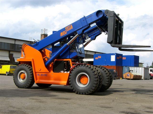

The compact truck is capable of reaching into a container, thus making container stuffing efficient. Thanks to its telescopic booms, container stuffing is possible without any use of extra tools. The direct hydraulic lifting is also simpler to maintain.
The horizontal telescopic twin boom configuration and hydraulically movable cabin design offer excellent visibility and comfort for the driver. The truck is equipped with electrically controlled, low emission Volvo engine, ZF transmission and electrically controlled load sensing hydraulics and variable displacement pumps, combined with CanBus technology for reliable operation.
The machine has a maximum lift height of 6 m and outreach of 2.25 m. With the machine length of 6.03 m (without forks), width of 2.85 m and turning radius under 5.5 m it is the most compact lift truck on the market in its lifting capacity range.

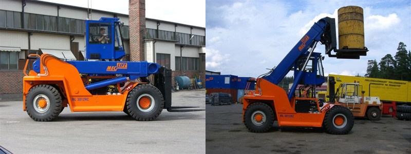

ML 3012RC with cabin in lower position

ML 3012RC with a 30 ton test load
