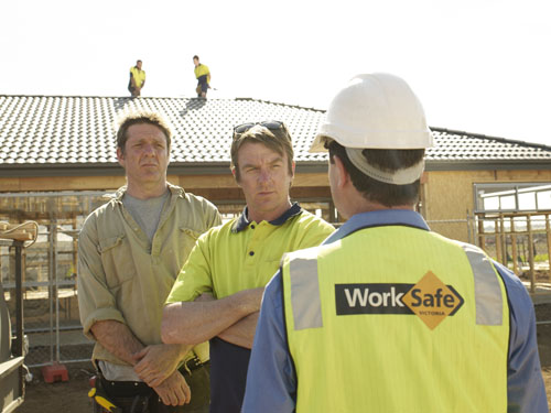

WorkSafe Victoria has found Vegco employees working without harnesses.

The court heard that in October 2020, two workers were investigating a chemical smell coming from a sloping roof at the factory.
The pair used a scissor lift to access the roof, which was up to 8 m high and wet from overnight rain.
During this process, a WorkSafe inspector visited the site as part of a routine inspection and observed the men working without harnesses or other fall protection in place.
The inspector also found that although the scissor lift was operating in a shared zone with pedestrians, vehicles and other mobile plant, it had no impact protection, and the two workers were not trained, instructed or aware of the company’s traffic management plan for mobile plant.
