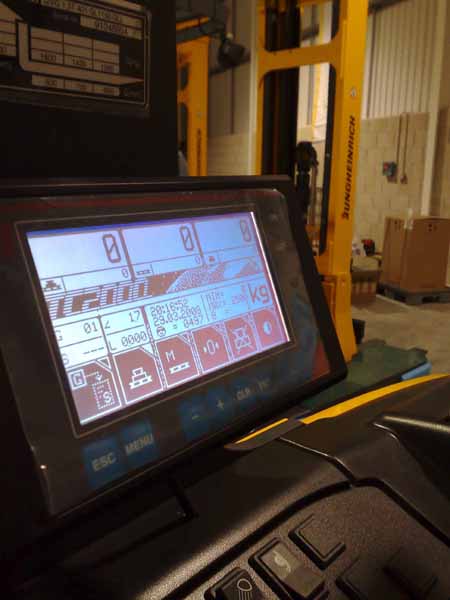

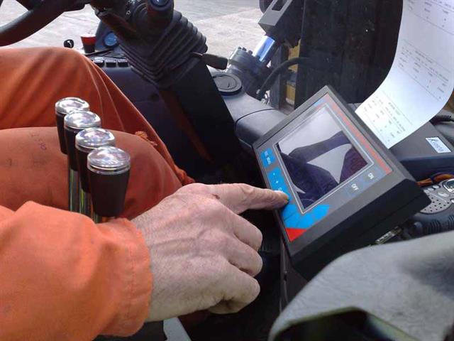

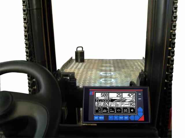

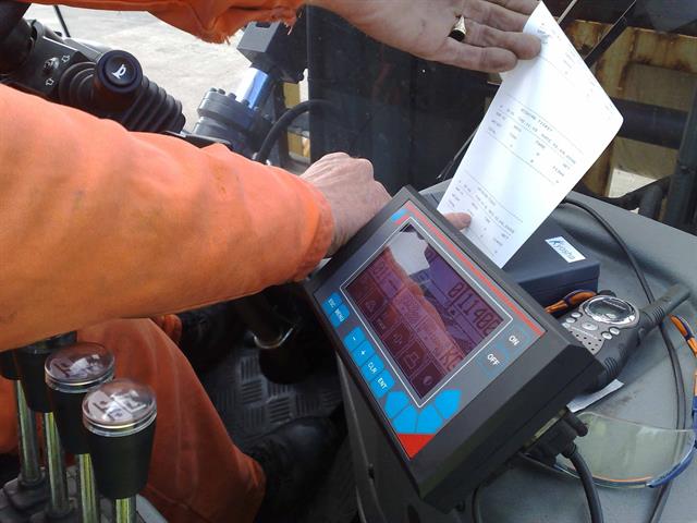

VANGUARD has a user friendly interactive LCD screen that makes the device easy to calibrate and operate. The LCD screen menus and self diagnostics make it easy on the installer.
The VANGUARD system will also log weighing events in up to 99 different channels with up to 99 different weighing events per channel. The device is standard with a RS232 serial port for exporting event log data and printing adhesive or receipt labels. All weighing events can be viewed and recorded in Lbs or Kgs and are time and date stamped with the accurate weight in chronological sequence or channel sequence.
