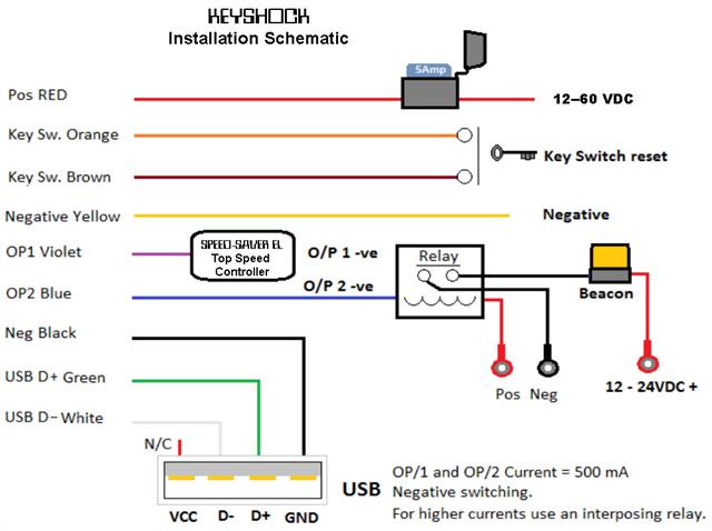

  • Two alarm outputs; alarms when impact deceleration is in excess of trigger threshold set-point.
  • Alarm software settings can be set to "latch" (stay on), pulse, output for 6 seconds, pulse for 100ms.
  • When set to "latch" (stay on) it can trigger flashing siren alarm vehicle has been involved in impact!
  • When set to "latch" (stay on) then a key reset from supervisor is required (optional key switch).
  • "Latch" can also trigger low speed on SPEED-SAVER top speed controller or relay for shut down.

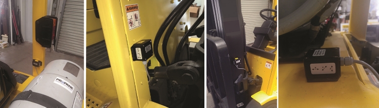

  • Because it has 3 axis, module can be fitted horizontally or vertically (see vertical picture below).

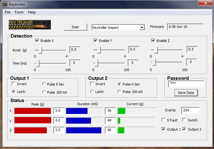

PROGRAMMED VIA USB PORT - PC SOFTWARE IS FREE!
  1. Password protected log in for settings.
  2. Enable/disable any of X-Y-Z axis.
  3. Set sensitivity for each axis independently.
  4. Set "ignore" time for each axis (ms).
  5. Set style for each output independently.
  6. View current output of each axis (helpful in setting accurate threshold

KEYSHOCKS small profile 95mm x 58mm x 32mm (3.7" X 2.3" X 1.2") fits easily to many mounting locations on a vehicle and the device will fit to any 12, 24, 36 or 48VDC power supplies. The unit consists of 2 components:
1. A completely weather sealed heavy duty cast aluminum module.
2. Wiring harness. All electrical connections are made at this harness.

Counter in software shows how many impact events over threshold settings have occurred.
PROGRAMMING:
The user connects to the device via a USB connection where the sensitivity thresholds are set. He can also set the two outputs to "latch" (stay on), pulse, output for 6 seconds, pulse for 100ms. When set to "latch" stay on the user must have the optional keyswitch installed that the supervisor uses to reset the unit (turn off the alarm and/or re-enable the vehicle ignition circuit)
