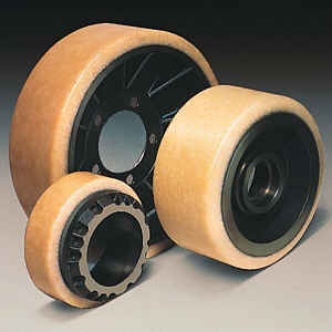

Tractothan wheels by Raeder-Vogel
Polyurethane, urethane and press-on tyres are used mainly in warehousing applications on narrow aisle and very narrow aisle vehicles and smaller capacity forklifts working indoors. Polyurethane tyres are often produced as a single unit of both tyre and wheel. Polyurethane tyres are also used in applications where rubber tyres just aren't resilient enough, such as in working environments of extreme heat or cold or in warehouse applications moving heavy loads over sustained periods of time.

Like rubber tyres, polyurethane wheels and tyres have many of these capabilities customised in the compound. Raeder-Vogel has developed Tractothan, a composite material based on Vulkollan but characterised by better traction.

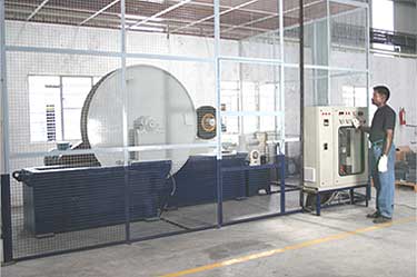

Sun-TWS's iLastic intelligent elastic production control system
A spokesman for Sun-TWS, a manufacturer based in Chennai, India tells Forkliftaction.com News that all steam used in the production process at their plant is generated from eco-friendly waste material.
