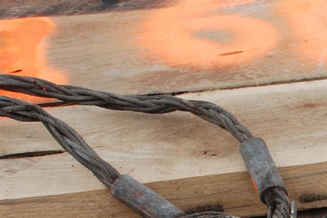

A safety cable hooked to an eyehole at the top of the attachment.

Bishop Lifting Products Inc made the attachment, which was supposed to slide onto the forks, be secured to the carriage with a safety cable hooked to an eyehole at the top of the attachment and lift loads using a sling connected to an eyehole at the bottom. "It was designed to aid in lifting odd-shaped loads and equipment," Escamilla notes.
"The safety cable was not properly looped to the carriage and when the forklift operator inadvertently tilted the forks down, the load of drill collar slips weighing approximately 380 pounds (171 kg) and the attachment of about 127 pounds (57 kg) slid off the forks," Escamilla says.
Inadvertent tilting of the forks and improper securing of the attachment were the immediate causes, he says. "If (the attachment) had been properly secured, the tilting of the forks would have made no difference. Other causes were that the product came with no manual, instructions or warnings for this risk. Rincon had not completed rigger training. Both the attachment and the forklift were new to the end-users."
