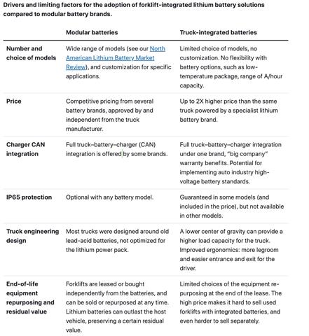

The first lithium integrated trucks by BYD and Linde came to the market back in 2014. However, the sales numbers of forklifts with integrated Li-ion batteries are still limited in 2022 when battery specialist companies are selling thousands of lithium units each year. What is holding back the forklift manufacturers?
Cost
Forklifts with an integrated lithium battery would be higher in price than a regular electric forklift with a lithium battery from a battery specialist company. Buying a truck with an integrated lithium solution can be twice as expensive as an electric forklift with a US brand of an industrial lithium battery pack.
Product line
Very few businesses on the US market can be considered “standard”. Many traditionally operate over multiple shifts and weekends. The current low number of models of forklifts with an integrated lithium battery pack is not encouraging the use of these trucks in applications with non-standard operations, which often require a higher battery capacity to power attachments, move and lift heavy loads, or support longer hours of operations.
Some European brands of lithium-first forklifts (such as Jungheinrich) may be popular in their home markets, but have lower traction in the US precisely for this reason: a “standard” Ah capacity across a few models in their product line. In many cases, customers need “more gas in the tank”, and these batteries are only available from a specialist lithium battery manufacturer.
Ergonomics
“Built around the battery”, these trucks can reduce the battery compartment, as the lithium battery pack is much slimmer than lead-acid. This leaves more space for the operator’s cabin, providing more leg-room and making it easier to enter and exit.
One important benefit of an integrated lithium battery: the truck is designed with a lower centre of gravity, which improves stability, manoeuvrability, and speed. These forklifts can safely handle heavier loads with lower counterweight requirements.
Integrated charger
Some of these forklifts come with an inbuilt 110 v charger. It is useful when equipment needs to be carried around and the materials handling equipment has to be charged outside of its home facility; for example, a pallet jack that is used in box delivery by a commercial truck.
A 110 v charger with an output of 20–50 Amps is not powerful or fast enough when it comes to a bigger battery. Fast, efficient charging will certainly require a more powerful external charger. Class I and II lifts typically use 480 v three-phase chargers that put out 120–300 Amps.
IP65
Ingress protection against water and dust is essential in some operations and is a really useful feature. In many cases, like in meat/fish processing plants, the materials handling equipment also needs to demonstrate top performance over multiple shifts in low ambient temperature. The advanced insulation of the FROST package, which keeps the battery warm, combined with high capacity to support the long hours of operation, only comes with a specialised lithium battery and is not on the menu with forklift OEMs.
CAN integration
It is important that all three elements of the equipment —  the forklift, battery and charger — are fully integrated to maximise efficiency and safety. One engineering solution could be to create a locked system. But you can also make all elements universally compatible!
The truck’s controls and indicators use the battery data and improve the operator’s safety. Seamless CAN integration of a battery and charger provides maximum charging efficiency and minimises the loss of energy.
Integrated lithium solutions provide all these benefits in locked systems, but so do batteries and chargers approved by OEMs. In fact, some OEMs outsource batteries for their systems, offering the same model you can buy on the market as part of its branded (and more expensive) “lithium-first” solution.
All customers would certainly benefit from the development of universal standards for CAN integration of batteries with lift trucks and chargers. Closed systems stifle competition and drive up the price. No-one is happy with a cell phone locked to one operator, and an expensive charger with a unique connector.
