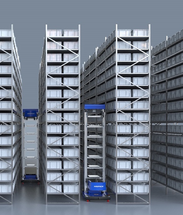

HAIPICK A42T
HAIPICK A42T
HAIPICK A42T
The HAIPICK A42T is the world's first telescopic autonomous case handling robot (ACR). The telescopic lifting function allows a flexible range from 250 mm to 6.50 m. The robot itself maintains its standard height of 3.70 m.
The advanced robot enables intelligent and efficient goods-to-person picking in warehouses with irregular heights. The available space is utilised to the maximum, resulting in high storage density, even in environments where the warehouse height varies.
The system intelligently identifies, locates and collects the desired item. Each storage location has a DM code for this purpose. The HAIPICK robot first scans the position code and then the bin code.
The system is designed for mixed picking of both totes and cartons of different sizes. The ACR can pick up to six totes at a time and transport them to one or more workstations.
Obstacles such as sprinklers, doors, fans and other height-limiting objects are registered in the HAIQ software platform. The ACR knows where the obstacles are, can adjust its height and continue the route. To further increase safety, the mast can be equipped with additional sensors.
By default, the robots are active in a closed area. If pedestrians are also on the move there, the system can be expanded with additional sensors. These detect possible obstacles and ensure that the robot comes to a safe stop.
ACRs included in the HAIQ software platform can automatically switch from one area of operation to another. The robot can also control lifts if they are connected to the HAIQ software platform. In that case, DM codes are installed in the lift to control the ACR and allow it to be used on multiple floors.
The lithium iron phosphate battery allows for quick and easy intermediate charging. According to the manufacturer, the battery can be recharged in just 45 minutes. This makes the system suitable for 24/7 operation.
The HAIPICK system is scalable and can be easily expanded with more ACRs, more workstations or more racking systems depending on requirements. Other storage systems such as miniloads or shuttles can also be integrated.
Unfortunately, the HAIPICK A42T could not be verified live in Dortmund for testing. Verification was carried out by means of video streaming and manufacturer interviews.
IFOY test verdict:
The HAIPICK A42T is a unique autonomous case handling robot (ACR). Thanks to the telescopic lifting function, the robot's mast can be extended to a height of 6.5 metres. It can also be used in environments where the storage height varies. The height of the robot is automatically adjusted to achieve a high storage density.

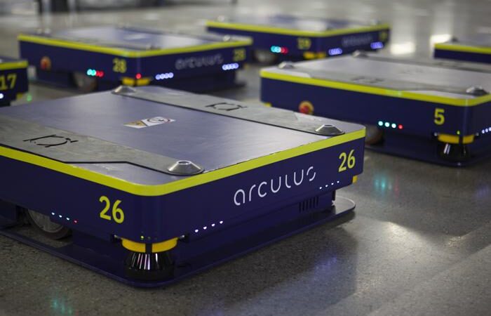

arculee 2
arculee 2
arculee2
The arculee2 from the manufacturer arculus is the successor to the arculee1. It is available in three sizes with load capacities of up to 1 T.
The arculee2 is controlled by a robot control unit that enables fleet learning and over-the-air updates.
All data converge on an integrated card from which the AMR is controlled. The advantage is that the number of components, and thus the costs, are significantly reduced. Ultimately, users get more for their money.
In combination with the arculus Modular Production System, the arculee2 transports containers and pallets from one workstation to another without predefined routes. The AMR locates and navigates freely based on sensor data fusion.
The robot collects information using multiple sensors, accelerometers, cameras and even body microphones. Based on this data, the arculee2 creates an image of the environment and the robot's performance. This enables dynamic driving and navigation behaviour and also helps to optimally and efficiently plan reloading and service.
The exact positioning also behaved extremely flexibly in the test. For example, if the load was not completely straight, the arculee2 recognised this and easily adjusted its position in relation to the load.
Most of the calculations are performed in the robot itself with minimal energy consumption. Thanks to the patented electronics and software architecture, upgrades can be quickly and easily transferred to AMRs, for example via 5G or WiFi.
arculee2 is a universal platform. Its functionality can be extended with various attachments if required. The integrated battery is charged online, ensuring maximum availability. New charging points can be added flexibly and within just 10 minutes.
The test team is convinced that this system can further increase efficiency in both production and logistics environments while saving valuable space. The availability of goods remains high.
IFOY test verdict:
As the variety of products in AMRs grows rapidly, the differentiator is not so much the hardware as the software. Easy implementation and integration as well as management and possible changes are in demand. In this regard, the arculee2 performs above average compared to the competition. The arculee2 is extremely robust, extremely compact and, thanks to the flexible customisation and update options, also future-proof.
