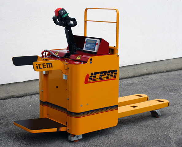

TPC-AR, version with weighing system

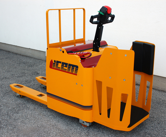

TPC-AR with fixed platform
The pallet truck is supplied with different types of operator's platform, side guards and/or fixed rear guards, configured according to the needs of the individual customer.

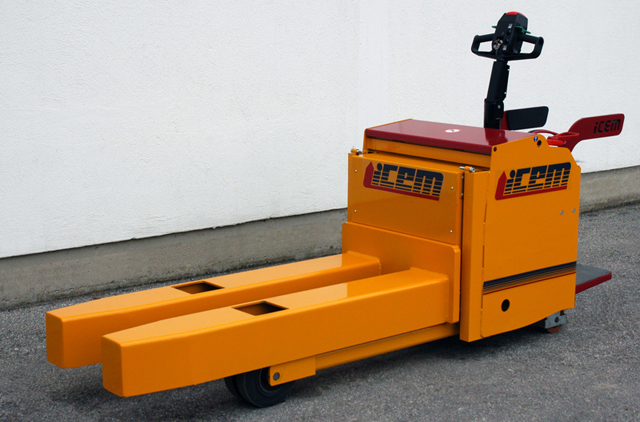

TPC-AR with special forks

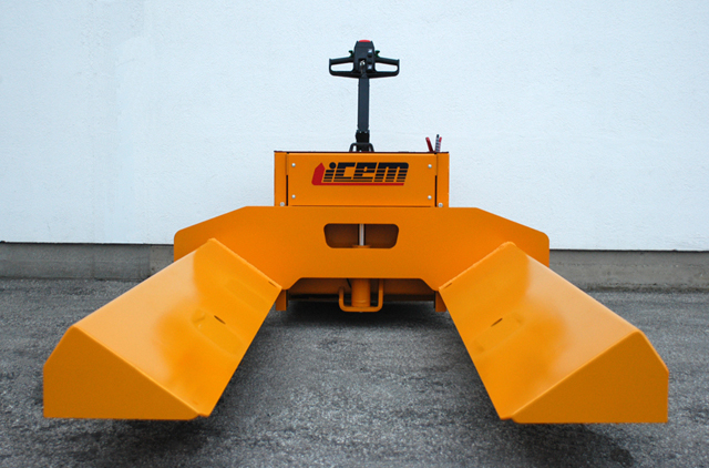

TPC-AR with concave forks
