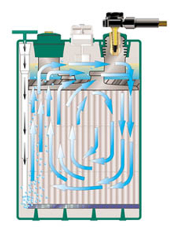

The HOPPECKE trak® air principle
When a battery is charged, concentrated sulphuric acid is formed. In comparison with "normal acid", concentrated sulphuric acid is heavier, and sinks to the bottom of the cell, resulting in acid stratification.
To cancel out this stratification mixing of the electrolyte is usually achieved through rising gas bubbles. In standard systems, this gas is produced by defined overcharging of the electrodes. However, this deliberate overcharging means increased energy and water consumption, extended charging times and higher temperatures.
The HOPPECKE trak® air concept avoids these negative consequences. Air is introduced into the battery right at the main charging stage. The rising air bubbles circulate the electrolyte, thereby preventing stratification of the acid.
In comparison with other mixing methods, mixing of the acid by in-blown air gives the greatest efficiency combined with minimal stress on the plate group, and eliminates the need for the otherwise necessary weekly equalising charges.
