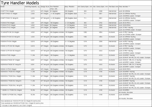

MODELS AVAILABLE
A full line of dedicated and dual use tyre handler models are available from 2265 kg through 16,330 kg of handling capacity.

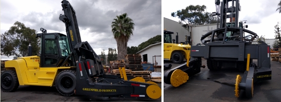

Demo/Stock unit available in Australia
H16XM-6 coupled with Greenfield Tire Handler TH15A ready for action!
