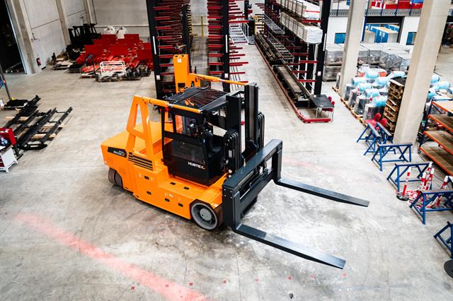

Hubtex has expanded its range with the RoxX compact forklift series.
The RoxX series combines a high load capacity with a compact design. The industrial truck is up to 25% narrower and around 20% shorter than classic forklifts and is available in load classes from 8 T to 30 T.
The optional electric steering saves even more space which makes it 30% more efficient than trucks with electro-hydrostatic drives. A new, patented single-wheel steering system further reduces the turning radius by around 50%, compared to the standard steering system.
Hubtex offers three types of lift mast: a two-stage Simplex mast with a lift height of 3,400 mm as standard, a two-stage mast with full free lift (Duplex), or a three-stage mast with full free lift (Triplex). All models can be tilted from −5 degrees to +5 degrees.
The spacious driver's cabin boasts large windows for improved visibility.
The cabin can also be easily folded down to enable fast response times and easy maintenance in the event of a service.
