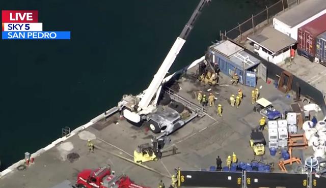

A worker has died after becoming trapped under a forklift at the Port of Los Angeles.
The Los Angeles Fire Department said it received reports of the incident on Monday morning at Berth 270.
Emergency responders pronounced the trapped person dead on the scene. Local media reports identified the deceased as a man in his 30s. The cause of the incident has not yet been ascertained.
Authorities from multiple agencies are investigating.
