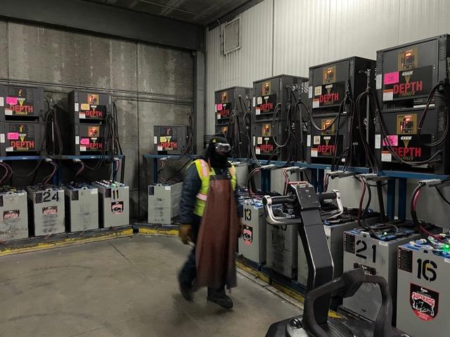

Forklift battery safety is a critical concern in industrial environments and adhering to the guidelines set forth by the United States' Occupational Safety and Health Administration (OSHA) is essential for maintaining a secure workplace.
Proper forklift battery handling, as highlighted by OSHA's Severe Injury Reports - mandatory for employers in the United States to file since January 1, 2015 - plays a significant role in reducing workplace accidents.
These reports have recorded 60,912 entries as of August 2021, with a small fraction, less than 1% (52 incidents), relating to injuries from handling batteries for electric forklifts, pallet jacks, and electric vehicles.
OSHA data shows most battery-related incidents occur during battery moving or watering
To enhance forklift battery safety, it's crucial to understand the risks involved in battery replacement, relocation and maintenance, processes that have historically led to injuries like fractures, compressions and acid burns.
These incidents underscore the dangers associated with the substantial weight, large dimensions and chemical hazards of traditional lead-acid batteries.
