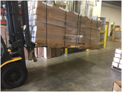

Have a look at your warehouse or dock. Instead of looking at the inventory or your employees, focus on the walls and shelves. What do you see?
If you notice dents in pallets, holes in walls, or even damage to your goods that have the distinctive shape of a fork end – you may be using forks on your forklifts that are too long.
Pallets are usually sized following a specific standard. For your employees to safely move the loaded pallets with their forklifts to their nominated destination, the forks should be long enough to ensure full support and stabilization of the load.
If the ends of the forks protrude past the outside edge of the pallet, they can cause a problematic and even dangerous situation. Protruding forks are like an accident waiting to happen. The same goes for forks that are too short.
