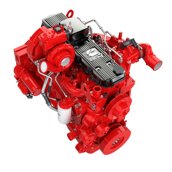

Cummins B6.7 Performance Series
A further benefit is the new ENCOMPASS Extra extended warranty program for Performance Series engines. It provides a range of engine coverage options up to 5 years with unlimited hours (8,000 hours on the F3.8 engine). It can cover parts and labour or parts, labour and travel depending on customer needs. Additional coverage is also available for the Cummins aftertreatment system to provide the same protection level as with the engine.
The simpler configuration of the Performance Series engines enables a competitive program with no excess. This has a positive impact on cost of operation and protects both forklift owners, as well as forklift rental companies from unexpected costs. Customers should contact their local Cummins distributor to talk about ENCOMPASS Extra options and pricing.

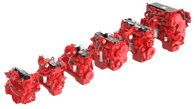

Cummins Performance Series Line-up
