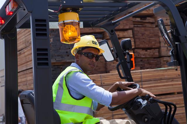

A blue spot light system and flashing beacons warn pedestrians.

The most common aids to warning pedestrians of approaching lift trucks include the clear blue spot light system and flashing beacons. In corners, potentially hazardous aisles and blind spots used by both pedestrians and forklifts, it's also advisable to think about two-way traffic light systems. The driver can set a red light to keep pedestrians away until the area is safe, and in the same way a pedestrian worker needing access to the area can set a red light to keep out trucks.

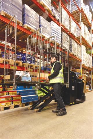

Sometimes the answer to a safety problem lies in a very simple practice rather than high technology. When pedestrian workers need to enter a warehouse aisle to inspect products, they can place a movable sign at the end of the racking which tells lift truck operators to stay out. If the operator urgently needs access, he or she can walk over and ask the pedestrian to stand somewhere safe until the truck passes.

The answer to a safety problem may lie in a very simple practice.
