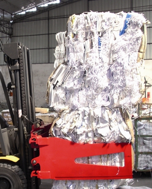

"Some parameters allow you to identify the most suitable attachment for the handling case" adds Fausto. "Let's assume, for example, to handle waste paper bales. Focus the attention on the family of the parallel clamps, and more precisely on the bale clamp with strong ribbed or slim arms.
The analysis of the above examined load factors allow to identify which is the attachment capacity, the opening range and the arm dimensions.
The working factors of the clamp also define the size (or oversize) the clamp will have (bigger for harder working conditions).
Now we are able to list the technical and dimensional features which the ideal clamp should have" continues Fausto.
