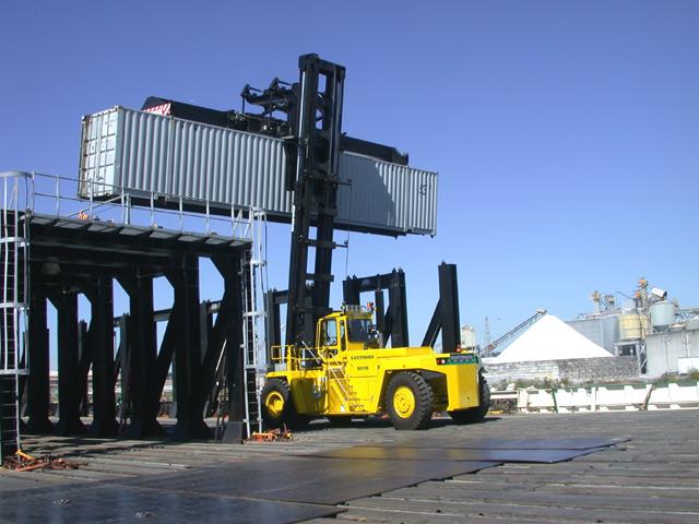

The Svetruck S1150/225 entering rack area on rail barge.

Daniel Andersson, design engineer with Swedish forklift manufacturer Svetruck, said his company got involved with AML when it acquired Kaldnes in 1999. "Kaldnes had been supplying AML with forklifts and we took over the contract to finish delivery of four trucks AML had on order," he said.
Delivery of those four trucks increased the AML fleet of heavy forklifts to 20. AML approached Svetruck to build a short wheelbase machine that had the same features as the Kaldnes-built truck but an increased lift capacity from 45 tonnes to 55 tonnes.

"Svetruck has delivered AML both top pick/gantry trucks and fork-dedicated trucks," Candee said.
Svetruck forklifts built for AML are designed to stack containers five high, which although not innovative, is unique because the majority of AML containers are 10 feet (3.05 metre) tall and 102 inches (2.6 metre) wide. Five-high stacking of 9 foot 6 inch (2.90 metre) tall by 96-inch (2.44 metre) wide containers was first accomplished by Hyster for AML's South East Alaska operation in the late 1970s. That operation focused on 20-foot (6.10 metre) and 24-foot (7.31 metre) long containers that were 96 inches (2.44 metre) wide and 8 feet 6 inches (2.59 metres) tall.
"To service the full height of a typical container stack on today's barges, a forklift must have a maximum top of fork height of 504 inches (12.8 metres) and a bottom of twist lock height of 638 inches (16.2 metres). Additionally it must have 15 degrees forward and back tilt to maintain containers in a level condition as the forklifts travel on steep ramps on and off the barges," Candee said.
