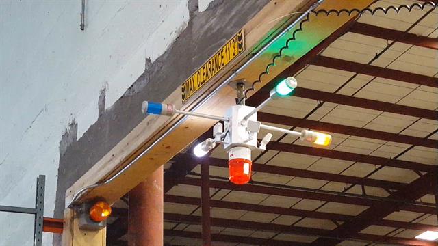

With AISLETROLLER, pedestrians and forklifts can "see" if there is another pedestrian or vehicle approaching at busy intersecting aisles.
  • EASY INSTALLATION
    Mounts to ceiling and plugs into 110 VAC outlet Device's coiled cord plugs into 110VAC outlet. Mounts to ceiling above and hangs down in intersecting or blind aisles. Client can use 1--2---3 or 4 sides to detect movement.
  • 4 Doppler radar modules
    One on each side - East, West, North, South facing
  • Adjustable radar sensitivity
    Dial adjustments for detection range and for time off after NO movement --- settable for each side
  • Adjustable radar module
    Manual pointing adjustments up/down and side/side
  • Different Colored LED and end of each side
    Side that sees movement alights until movement is no longer detected
  • When 2 or more Colored LEDS alight
    Then flashing rotating red siren beacon in center alarms until movement is no longer detected.
  • Device is NOT magnetic and NOT infrared---the radar module detect movement regardless if it is man or machine
AISLETROLLER Intersecting aisle radar warning device
How it works:
  • Each radar module "watches" in direction it is pointed in
  • Doppler radar picks up movement of pedestrians or vehicles
  • If there is a pedestrian or a vehicle approaching the intersecting aisle, then LED on that side alights
  • When 2 or more LEDs light center red siren alarm sounds (can had audible or set to no audible)
