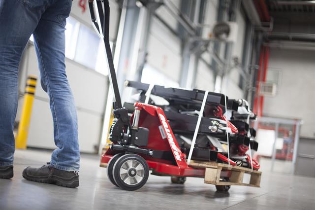

The hand pallet truck should be pulled with one hand while the operator faces the direction of travel, to ensure visibility and control are maintained.

Mentor's hazard perception test highlighted one of the most common errors surrounding this type of equipment - pushing rather than pulling a hand pallet truck.
The truck should be pulled with one hand while the operator faces the direction of travel, to ensure visibility and control are maintained. Results show only 42% of managers and supervisors identified incorrect use of these machines as a risk factor.
