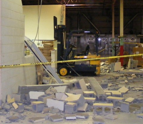

A police report identifies Jose Hernandez, then 22, as the operator of an electric cushion-tyre Daewoo rider model BC18T forklift with a three-stage mast and a rated load capacity of 2,900 lb. (1,305 kg).
VDLI says the operator placed a barrel of lecithin emulsifier onto a rack in the mixing room in order to begin the mixing process. He backed up with the forks elevated to manoeuvre out of the room and clear the mixers that were beside the barrel.
"The operator did not keep a clear view of the path of travel since the mast of the fork truck struck the top of the wall opening as the operator was traveling backwards", VDLI says. "The wall collapsed outward causing (cinder-block) debris to be thrown several feet onto the production floor" causing fatal blunt force trauma head injuries to an employee. Police say the victim was product packer Rosa Hernandez-Arellano, 37, mother of the forklift operator.
VDLI elaborates: "At the time of the accident, the mast was extended in the air greater than the opening of 10 ft. (3 m) which caused the mast to strike the doorway opening as the operator was traveling backwards out of the mixing room into the production area. The operator did not keep a clear view of his path of travel to include all sides of the fork truck which would encompass the mast that struck the opening."
