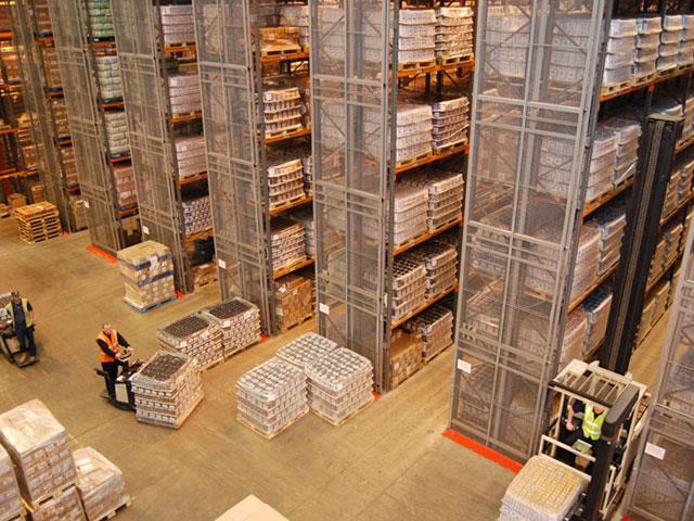

CERT's facility has 6,000 aerosol pallet positions with projectile fencing around Zone 2 areas.

To meet the regulations, CERT invested GBP750,000 (USD1,495,576) to upgrade Rotherham. A 12.5 metre high projectile fence was placed around the 6,000 pallet positions to contain the aerosols in the event of an explosion and a penstock valve was fitted to contain fire water.
The storage areas are classified Zone 2 under DSEAR regulations and all equipment operating in the areas has to comply with the ATEX 94/9/EC directive.

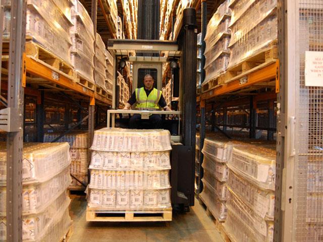

Health and beauty deodorants being handled at CERT's Top Tier COMAH site by Crown equipment explosion protected by Pyroban.

The upgrade coincided with the need for a new forklift fleet and Crown was selected to implement a fleet replacement program consisting of TSP man-up VNA trucks, WP2330S powered pallet trucks, ESR4500 reach and SC3200 counterbalanced trucks.
Crown's account manager Simon Barkworth says explosion-proof specialist Pyroban was brought in early in the program to ensure the forklifts operate safely in a Zone 2 hazardous storage system.
The forklifts were fitted with Pyroban's 5000E gas protection system at the company's West Sussex factory.
"The system combines active gas warning and equipment shutdown technology with a range of explosion protection solutions. The user benefits from the early warning of a problem, automatically shutting the equipment down if a hazard is detected."
Due to their size, Crown turret trucks had to be converted in three sections at West Sussex. They were later assembled at Rotherham, where Pryoban conducted a final test of the system.
