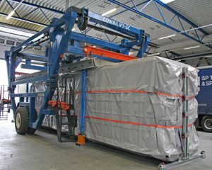

Safe and efficient handling and storage of loads up to 14 m (46.0 ft.) long, 3.3 m (10.8 ft.) wide - and weighing up to 30 T - was also an issue.
Combilift consulted with Andresen's management to identify the Combilift straddle carrier as the one-machine solution for the two sites. Each straddle carrier was adapted to take into account the slightly differing loads, with one model built with a larger frame to cope with double-stacked containers.
Andresen did not want to invest in pieces of equipment that could only carry out one specific job. So options like a combination of mobile cranes and traditional counterbalance forklifts, or reach stackers were discounted. He was also focused on the total cost of ownership.
According to Combilift, a major advantage of the straddle carrier compared to other comparable machines is its much lower weight and therefore greatly reduced ground pressure.
"Our calculations based on a 10-year operating lifetime took in initial capital outlay, fuel consumption, service costs and the reduction in wear and tear on the surfaces, and proved that we could achieve major operational savings compared to using any other type of equipment," says Andresen.
The machine's dimensions and its three-wheel manoeuvrability enable it to access the production area to load crates containing up to seven steel shells, weighing from 1.3 T to 3.25 T each. It can then load onto heavy goods vehicles without the need for a crane. It also handles incoming containers of components manufactured elsewhere. A spreader beam attachment with different lift points enables varying sizes of loads to be lifted.
