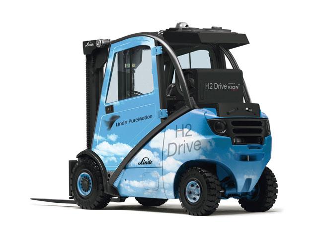

At CeMAT, Linde presented a concept forklift with a direct-injection hydrogen combustion engine. The three-tonne capacity forklift can reach its maximum power rating using hydrogen. There are no emissions as the hydrogen-powered engine turns the fuel into water vapour.
The forklift is based on the Linde 39X series and compared to equivalent models with conventional drives, it has a "thrust-controlled fuel tank system" and "intercooler attached to the overhead guard".
"The fuel tank system is mounted on the counterweight and is in-between the vehicle's b-pillar," a Linde statement says.
To replace the pressure pump, the fuel tank is reversed onto a rail system where the cartridge is removed from the side. The cartridge consists of a thin-walled inner aluminium container that is encased with carbon fibres and epoxy resin. It can hold about 26 litres of hydrogen that is equivalent to 2.3 litres of useable diesel.
The compressor-charged direct-injection engine with 2.0 litre piston capacity and a 43kW power rating, manufactured by Volkswagen Industrial Engines, is not visible from the outside. Hydrogen stored in the pressure pump enters the engine's combustion chamber directly, enabling the fuel to burn efficiently.
