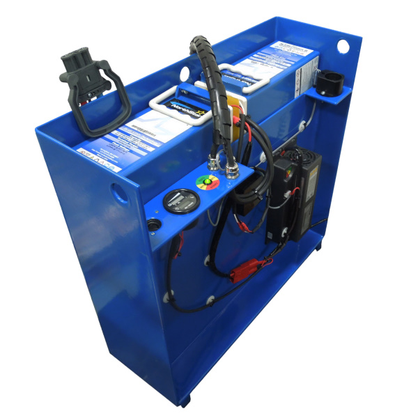

In addition to the environmental benefits, battery electric technology also provides economic advantages over diesel and liquified propane gas (LPG) engines. Operating and "fuelling" costs are significantly lower. Where it might cost USD6,000/year to run a diesel forklift, a comparable e-forklift may cost less than USD1,000/year. Kilowatts are cheaper than gallons! And with fewer moving parts than traditional combustion engines, battery electric vehicles require much less annual maintenance - in the order of 70% less per year than a diesel-powered forklift.
But it's not all zero emission nirvana with e-forklifts. CAPEX can be approximately 15-35% higher when buying e-forklifts. To be able to operate extended shifts, owners would need to purchase additional replaceable batteries that can run to USD5,000 a pop. E-forklift prices will gradually decrease as the technology improves and reaches scale economies, but the current price difference is significant. Plus, many e-forklifts can't be exposed to extreme weather and can only operate indoors. There's not much that can be done to change the weather outdoors, but there are several states such as Oregon, New Jersey and California that have implemented programs to help on the financial side of buying e-forklifts.
