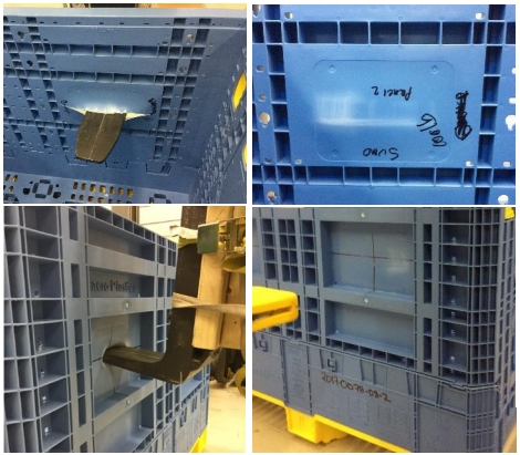

Under laboratory conditions, Virginia Tech used a pendulum impact test to evaluate the damage caused to plastic bulk containers by a lift truck's forks - with and without Sumo Gloves.
Representative damages of the ISO Bin after the impact with (left) sharp<br />fork tines and (right) using the SUMO gloves protected fork tines.
The containers suffered structural damage when impacted with less that 2,000 lb-ft kinetic energy by unprotected forks. However, once Sumo Glove technology was added, the containers experienced no damage after a four-fold increase in kinetic energy (nearly 8,000 lb-ft) and given a staggering 73 'hits' - at which point the test was stopped.
