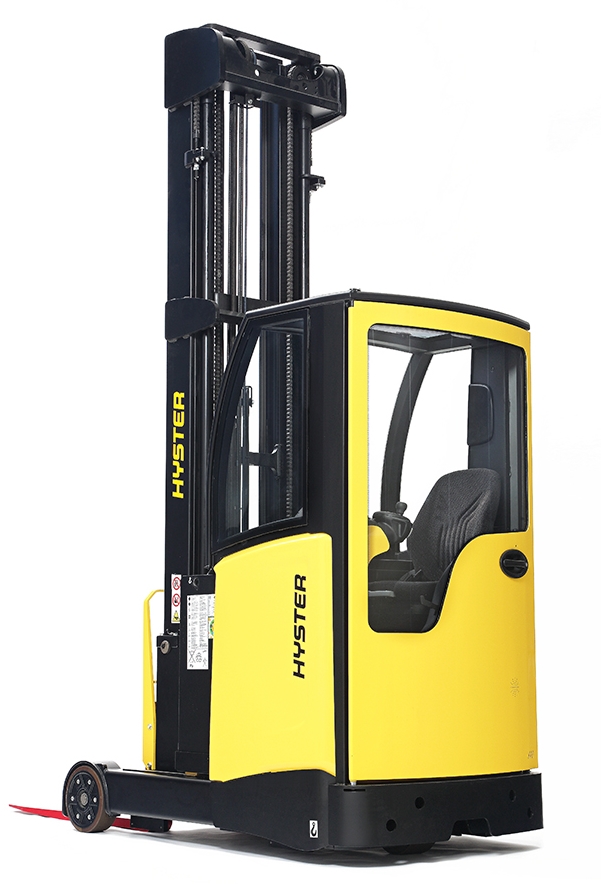

For cold store applications where the driver needs to be fully enclosed, Hyster has developed a new fully insulated cab for the R1.4-2.5 Reach Truck series (standard width).

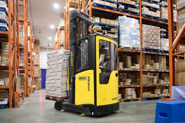

"In permanent operating temperatures down to -30degC, the Hyster truck's cab can maintain a comfortable interior temperature of 15degC," says Ron, explaining that a 2KW heater is integrated in the cab door, together with three small grid heaters to the mast side of the cab. There is a choice of five heating settings and it can be used in even colder temperatures but with more limited duration.
To prevent frost on the screen when the truck is being used on an in/out basis, two of the four front screen options are heated, whether glass or polycarbonate. For maximum visibility, the door has a wide view screen and there is a 9.5mm thick impact-tested polycarbonate overhead guard offering excellent visibility when putting away at height.
For drivers wearing bulky freezer suits and mittens, the door is easy to open and close, there is a low step up, plenty of room to move, a full suspension seat and an adjustable steering column. The driver can stay warm for a complete shift without cumbersome cold store clothing and can even communicate to other workers using an intercom system without opening the door.
