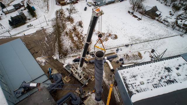

A MOD 70 spreader beam played a key role
Baltic mobile crane rental company Strele Logistics supplied lifting and rigging equipment, including a Modulift spreader beam, as a 49 ft. (15 m) chimney was recently installed at a biological waste treatment facility in Kaunas, Lithuania.
Strele accepted a scope of work to load the 35 m long, 2.75m diameter pipe where it was manufactured at Enerstena Group's facility, 3 km away, and erect it in its final location. It was first loaded onto a semi-trailer using two 15 T capacity overhead cranes that were already installed in the building, and a 90 T Faun ATF90G-4 mobile crane. Haulage firm Klaipedos Transekspedicija took care of overnight transportation to the jobsite.
The following morning, a 500 T capacity Liebherr LTM1500-8.1 and 200 T capacity Terex AC200 - the latter used for tailing - combined in tandem lift to complete the project. Below the hook of the Liebherr, a MOD 70 beam was used at 3 m in length, to accommodate rigging points manufactured onto the outside of the chimney.
Jok?bas Slavinskas, project manager at Strele, explains that, at one stage, a second spreader beam was considered with the Terex but synthetic slings were opted for instead. In total, four 10 m long roundslings, four 7 m steel cables, two 25 T shackles, two 55 T shackles, and two 85 T shackles (the last four connected to the spreader beam) combined to complete the lift.
The MOD 70 spreader beam played a key role, according to Slavinskas. "It performed well; it offered us what we needed and it was delivered in a timely fashion. Actually, we took the job without having the appropriate beam in stock, although we were already in contact with Modulift and were able to accelerate the buying process."
