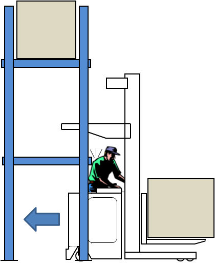

Sometimes, reach truck operators encounter an unexpected and dangerous “guest” in the operator’s compartment: a horizontal rack beam. It might just bump her. It might seriously injure her. It might kill her.
This rack beam intrusion is also known as underride. It occurs when a reach truck continues to reverse unimpeded into a horizontal rack beam, pinning the operator between the beam and the front of the compartment.

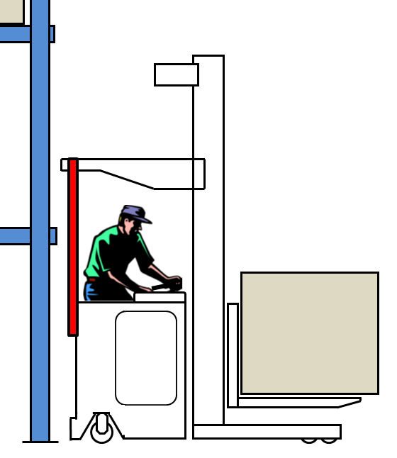

  3. Enclose one or both sides of the operator compartment rear with vertical posts. This adds physical barriers to the reach truck itself, running from the truck body to the overhead guard. This guarding provides the best compartment integrity.
Standup Forklift Underride
Standup Forklift with Rear Guarding
The Backbone for Reach Trucks is designed to provide operator compartment integrity. Its one-piece design means there are no welded joints, and no weak points to snap in case of impact. It’s been tested and verified to comply with ANSI/ITSDF B56.1 Standards.
