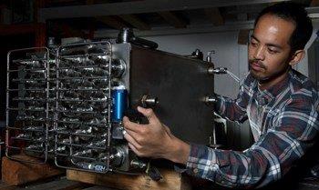

Adrian Narvaez of Hawaii Hydrogen Carriers with a metal hydride storage tank.<br />PHOTO: DINO VOURNAS
PHOTO: DINO VOURNAS
