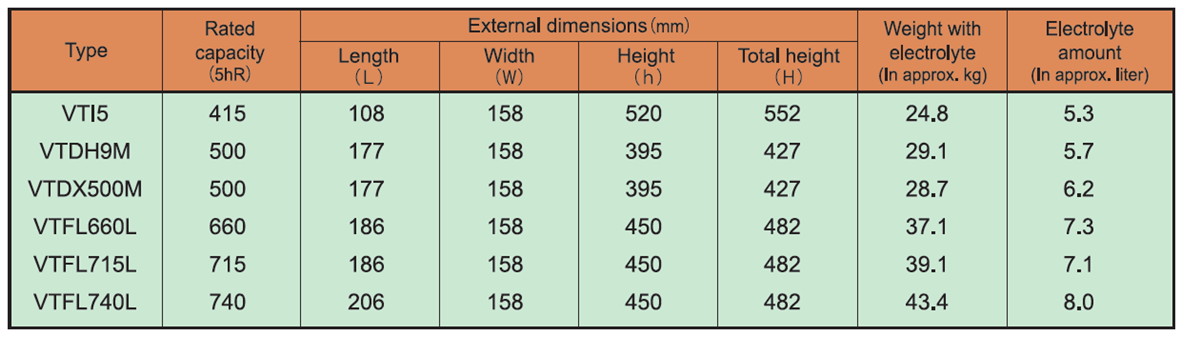

LIFTTOP provides specifications for a new battery type for Korean forklifts as well as battery care tips.

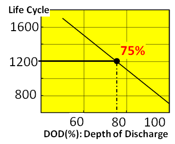

  • Keeping DOD75%.
What is DOD(%)?
  • DOD is Depth Of Discharge.
    DOD 0% is fully charged status. In case of 75% then Battery discharged 75%.
    DOD is an important factor for life cycle performance.
    If Battery was used under high DOD then Plate will be damaged earlier.
