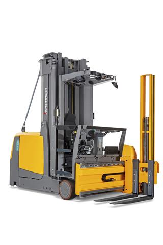

Jungheinrich has launched a new narrow-aisle forklift, the EKX 514-516 electric order picker and trilateral forklift. The combination stacker has a payload capacity of 1,600 kg and a lift height of 17.5 m.
The truck is equipped with state-of-the-art control technology, completely new motor technology and an efficient energy management system. Its intelligent lightweight design makes use of high-strength steels, resulting in a weight reduction of 150 kg. "This means we can guarantee the efficient and economical operation of the stacker over two shifts with a single battery charge," says Dr Klaus-Dieter Rosenbach, Jungheinrich's board member in charge of the Logistics Systems Business.
The EKX 514-516 is powered by new motor technology consisting of a synchronous reluctance motor which combines the high performance and energy efficiency of synchronous motors with the cost advantages and low maintenance requirements of three-phase AC asynchronous motors.
The new motor technology converts around 93% of the energy consumed into actual output, cutting energy losses by half.
For the first time, Jungheinrich is also equipping this model series with a patented vibration-damping system. The optional Floor Pro module reduces lateral oscillations of the mast and driver's cab which are caused by uneven floors or other floor types not designed for narrow-aisle forklifts.
The new EKX 514-516 is fitted with a number of modules for process integration, including RFID technology, redundant height and distance measurement and the Jungheinrich Logistics Interface.
